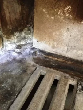

Chris, you do know that is advised against and can void the warranty? It is an easy way to crack the grate or worse the base of the stove. Here are a couple examples of what can happen.

Lol been doing it for 6 years. I dont do it from start up to operating temp.
The Isle Royale is a well built stove. The front lever (left/right) is the primary. The lever to the lower right is the startup (in/out). The salesman didn't have a clue. And never, ever use an unapproved startup method. Using the ash pan door is a very dangerous endeavor including overfire and the very real possibility of a flash back (ask me how I know).
I guess if you don't have much draft and can't use the air controls to start your stove, you gotta do something. I'd still sooner crack the door (which I have done) than to use the ash pan door. I like a moderate firing of the stove; Still gets up to temp plenty fast without excessive heat concentrated in one area.
You could still get the grate hot enough to crack even though the rest of the stove wouldn't be hot yet....
