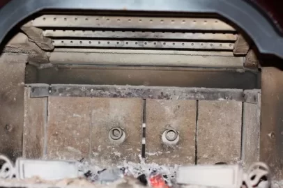

Ain't nothin but a piece of angle iron that holds the firebrick standing up. karrion - isn't this a new stove for you?? It really shouldn't be warped "yet". The only reason mine has a warp on it, is because its getting thin from years of dealing with close contact from fire. It can be straightened as well. It will simply lift out of place. This is such a simple piece, that I am gonna make my own replacement from some stainless angle. Hopefully that will last a little longer than the 6 (going on 7) years the first one did.

Yeah, that piece is positioned where it really gets attacked by the direct fire. I think you could consider it sacrificial. But hey, if I only gotta think about it every 6-7-8 years, no biggie. That is quite honestly the first and only issue I have had in over 6 years. Not a bad track record considering the fix can be had for 10 bucks and 10 minutes of time.

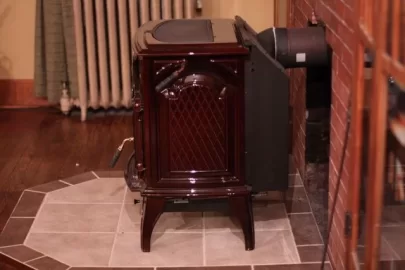

Some pics of my IR...............one good shot of the inside with the angle iron that holds in the rear firebrick.

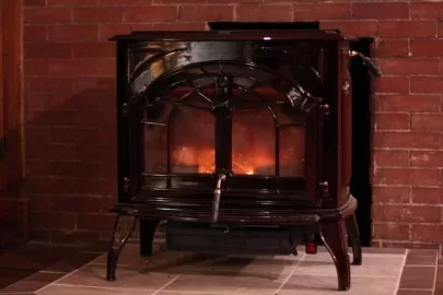

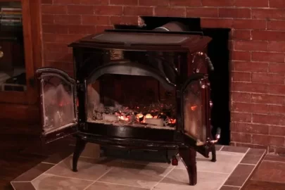

Couple more................

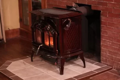

Last one...

Java, Very nice looking stove and install! The stove looks new and I thought it was a brochure picture at first.
Luv that stove, thanks for the pics java.
Nice stove!
