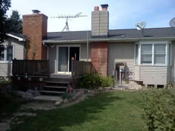

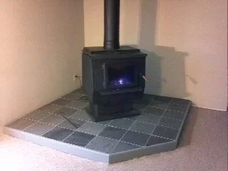

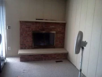

I'll not bore anybody with praises of the Blaze King, because it is boring. Fill it up and forget it for a long time. Just some before and after pics.

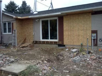

I've actually thrown some Tyvek up, and I'll take care of the siding in the spring. Also going to pour a concrete patio where the deck was, about 20'x40'.
Then and now...

Congratulations Jeff.
Never get bored hearing about good burning stoves irregardlous of the make.That is a nice setup and install.
That's alot more than a typical install. Demo/rebuild house project on top of a stove install. Yikes! Glad to see you buttoned up for the winter and ready to heat your place.
I'd say that taking out the old chimneys was a little over ambitious, but it sure looks nice!
It's been a 'journey' to say the least. I had a pretty good idea what I was going to find. I knew the roof leaked around both chimneys over the years (my father built the house, and things kinda went to hell after my mom died). I was expecting lots of rotted wood, and I wasn't disappointed. They terracotta liners in both chimneys were junk. There hadn't been a fire in the fireplace in at least 30 years, and I can't believe there was never a fire resulting from the wood stove vented into the other one.
I'm done outside for the winter. Got a lot of trim work to do, and some more painting. I think I'll relax and enjoy the warmth for a while. Then maybe cut some wood.
That big stove looks tiny on that huge stove pad! i think I would have put the stove closer to the walls and sized the pad down.
Awesome, awesome job !!!!!
Can't wait for fired up pics :)
Ha! I was thinking it was REALLY big, then we sat the stove on it. It's in a big room, and actually looks just right. Also, the foundation from the fireplace sits out in the room about 18", and is 78" long, so I made the hearth 7x7, and it covers up the concrete foundation. I put the chimney where it is without cutting any rafters or using any offsets, just straight up.

And thanks for the compliment. I'll not post any closeup of the joints. That corner was far from square, and my framing didn't end up as square as it should have. Let's say it's 'rustic' :)
Stove looks just right to me. From someone who has lived the Tyvek siding thing, I recommend screwing some 2x4s or strips of plywood in vertically every few feet to keep from losing it this winter if you get any wind there.
I think it looks great, good job! I plan to step up to a King if I ever expand my family room like I want.
Thanks, all. It's definitely a big stove, and it takes a big room. My house totals around 1600 ft², but living room/dining room/kitchen are all open and add up to about 1100 of that.

Since you asked for it. I loaded it up with ash at 1am yesterday before work. With the mild temps yesterday and overnight, my wife didn't touch it. I got home an hour ago, 36 hours later, to a 250° stovetop, and a bunch of charcoal chunks. I opened the thermostat and pulled the coals together and threw a couple of uglies on top. That will last until this evening, then we'll start over again.
