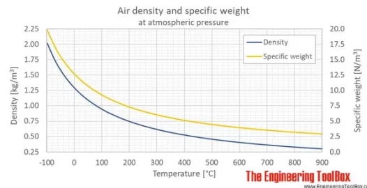

At 100 degrees C oxygen is zero, it doesn't seem efficient, it means that air passes into the stove, unusable, and the flames disappear, when the stove is hot
I think that chart is for dissolved oxygen in water. We preheat air to 750c at work before it goes in the combustion chamber on our reactors. We run a little over 1900c on the outlet of our combustors…@2% oxygen.
This is a graph of dissolved o2 in water. It’s an ideal gas law problem. The stoves intakes room temp air then heats it up and it expands it’s the same number of O2 molecules entering the stove.

Sorry for the graph, of water, this should be correct, basically, at 200 degrees C the oxygen is about half, yes, I want to understand how air expands but I don't think fire considers the volume of air but the percentage of oxygen. Yes, the motor discussion is a little different, to avoid self-ignition before the spark, cold air is necessary, but I also think the fire in the stove benefits from fresh air and not heat. Paradoxically warm air has the same oxygen but in a larger volume, Therefore less cold air is needed and therefore the purpose of preheating so as not to lose heat, becomes counterproductive, considering that by reducing the oxygen percentage, the flame may not be created, and therefore we only have air that takes away monoxide and smoke for the flue, instead of continuing the flame.
