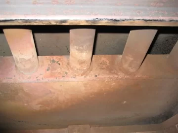

ok heres how mine is set up . if your looking inside my stove and up to the top of the inside, i have a baffle box to keep the flames in the firebox longer to help with secondary combustion etc etc , then you see 5 tubes coming towards the front of the stove (SEE PIC ) . those carry air that comes from the squirrel cage blower on the side of the stove , pulls it through an external tube that enters the back of the stove and into the baffle box and out the 5 tube pipes and right in your face. .. the air pipes are not in the heart of the coals to cool down the fire, though, the baffle box with the house air traveling through it is only 10" above the main coal bed. . .
my temp difference between the door thermometer location and the cooktop location is simply more direct heat is on the top of the stove than the thick door. im just pointing out that you cannot compare other peoples temps to yours, its apples and oranges... every stoves different.
