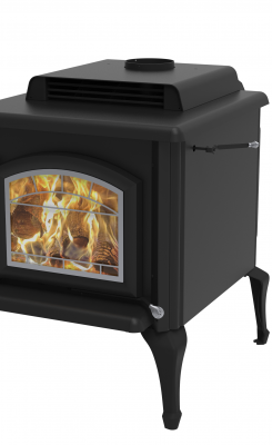

Hello,
I've been running an Englander NC30 in my 1800 SF shop building, insulated, 14' tall ceilings, for about 12 years. I use the building intermittently so when I burn the stove I burn it hot to heat up the large space. The NC30 has been fine, a little cracking, a little melting, both in the normal places and both safely. I closely monitor flue and stove temps to keep it safe but yes I run it at high output a lot.
I like a stove for this space. A wood furnace is less aesthetically pleasing and I really enjoy sitting by the stove to warm up vs. a ducted system.
Thinking about upgrading the stove before the fed rebate expires. I have been eyeballing the Woodstock IS because I think it would be a great stove to run, the price is decent and it is rebate eligible due to high efficiency.
Are there any other large, high output, efficient stoves out there at a similar price point?

The Drolet Austral III is probably the closest, but not that different from the 30-NC.
Some furnaces from Drolet are essentially their big wood stove with a blower cabinet. They have the same door and fireview as the freestanding stove. Englander did this with the 30-NC before SBI bought them out.

The IS is a 3.2 cubic foot box and since my wood is 16" long I don't usually get to fill up the 3.5 CF englander to the max anyway. Then since efficiency is so much higher with the IS I thought it would be a wash. The 3.5 englander keeps up just fine though not a very long burn time even when I try for a long burntime. It just goes through the fuel. Can't say much bad about the Englander other than low efficiency and I've had it so long that I might want to try something cool.
Oh and my stack is all vertical 19'.
The drolet would be a good replacement but not an upgrade. I just didn't know if there was another option out there.
Going to a cat stove like the IS would mean I could not burn anything of suspect origins such as oily rags. I burn them now to avoid the spontaneous combustion issue.

If you’re constantly having to warm up the shop from 50-70 years the Englander isn’t going to get much more than a 3 hour burn time since you’re running it balls out all the time.
In my house where it’s usually running consistently, with 12-14” splits (cut for osburn 1600) I was getting 6-7 hour burns with a 2/3 load on low. Not this upcoming season but next season, I’ll finally be into wood cut for the Englander at 18” and I’m expecting at least 8-9 hour burns times.
It’d be hard to convince me I needed heat for occasional use when it only gets down to 50 there, lol.
But assuming the bigger the stove, the more heat could be put out in a short period of time, I think I might look at the huge JA Roby stove that uses a 6” chimney.

My thoughts are that there is nothing to gain from a cat stove since you run hard most of the time...they are only efficient at lower settings.
Personally I'd either go with the big Drolet stove (at that point you may as well run your NC30 into the ground first) or go with the Drolet Heat Commander furnace, since you want the fire view, and the radiant heat to sit by.

The shop is well insulated. Outside temps into the single digits Fahrenheit with wind mean it will drop below 50 but those colder stretches don't last very long. I am burning after all and with the thermal mass of an insulated slab the shop doesn't cool too much overnight.
If no wood burning occured in the shop during a cold snap then it would likely cool to unsafe levels for the liquids in there.
