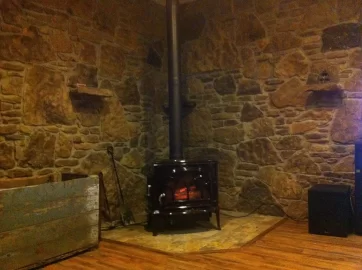

Mine is in the very same set up as yours. I do not and will not have the side door locked. I've got 5" thick stone on the walls and a concrete floor. It sits out pretty far and I see absolutely no reason to lock the door if it sits out a little and you have plenty of hearth. The side door kinda makes this stove in my opinion!

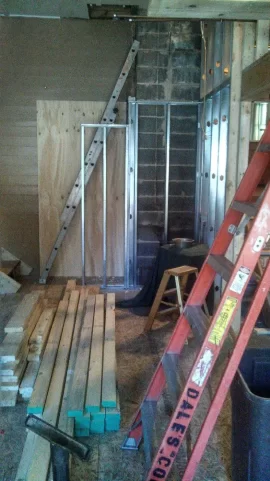

Moving the location of the hearth is unfortunately not an option. My walls are steel studded and will be covered with a cement board and then stone veneer. My raised hearth itself will be 5 ft deep along the walls and from corner to front edge will be roughly 5'8" so Idk if forgoing the manufacturer s specs is warranted. Any how your setup is beautiful webby!!!
This is the location of the hearth as you can see the poor castine in the bottom corner cover in the green sheet. :eek:

With this degree of protection it probably will be ok if you can move the stove out far enough so that there is reasonable side access. You don't want to be cramped loading a hot stove. If you want to be extra safe, put a vent at the top and bottom of the steel studded walls.
webby that is a beautiful stove and a beautiful install. I love those rocks.

Thanks! The stones were existing when we bought the place. Everything else is new, except the chimney. I hate that its not centered in the corner, but its a hip roof. The chimney was installed right beside the hip rafter. Ohh well!

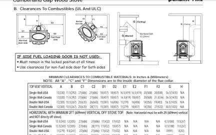

I was looking at the clearances for the quad Cumberland gap stove and it shows one dimension for the left side and then a different for the right side which is the wood loading side. Taking this in consideration if I use this larger dimension ( wood loading side) from the quad and place the Oslo for both corners to match this larger dimension I don't see why it's not ok....
These are the quad specs

Also let me ask this.... These "clearances" are all to combustible materials and I have steel studded walls so therefore the clearances don't apply? Just whatever works to operate the stove safely and is centered on the hearth?
You will find a different answer depending on who you ask.
"Clearance to combustibles" means just that. The nearest combustible material. Some say its to the surface nearest the stove since its attached to the combustible material. That just makes no practical sense to me.
Well the surface nearest the stove would be stone... non combustible....then cement board .... non combustible.....then steel studs.....non combustible so Idk where you would measure to trying to be on the safe side for peace of mind.
And as you do forget locking the side door correct. Do you know by chance what you have for measurements on your stove webby ?
It's 19" from the stone to the corner of the stovetop.
Ok cool thank you.
I read that years after I did mine. I have idea what could be the issue. Mine works perfect and has for 13 years. I have enough room to swing the door open past the wall and around the back of the stove. Plenty of room to load up to 26" splits. I have rear stove shield so the stove is back as far as I could get it. I think I emailed them and I never got a response.
That looks awesomer. :)
