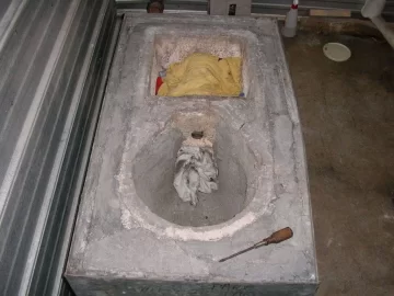

Refractory base repair in process. After your last fire the base needs 2 weeks minimum to cool before repairs can begin .

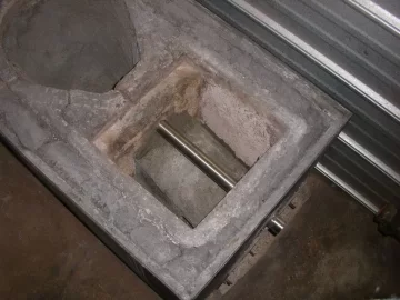

Settling chamber with modification , and new air injection tube.

New refractory liner

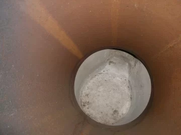

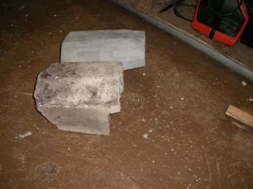

Tunnels.

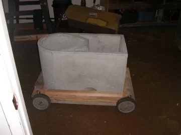

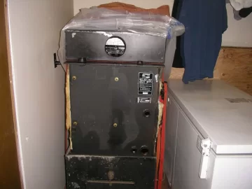

This is my spare #175 new and never yet fired ! I had a third but my family laid down the law and said 2 was enough.
Send question and I will do my best to answer.

I strengthened the area between the burn chamber and the settling area.

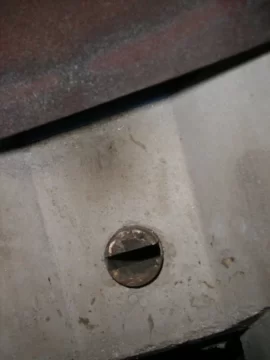

The end of the injection tube needs to be recessed on one side to give a swirling action of the air into the burn chamber.
Picture of the tube end on unit 175 .

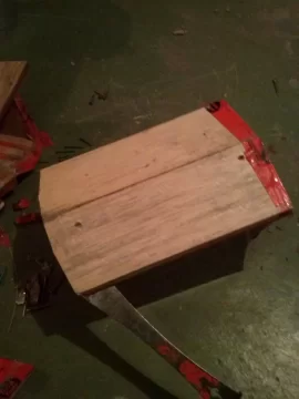

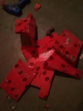

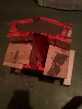

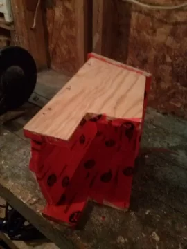

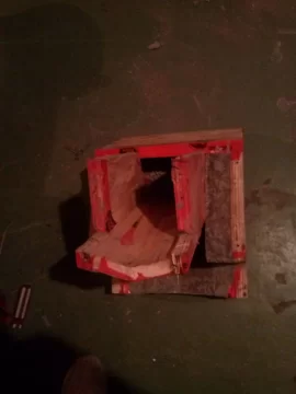

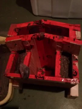

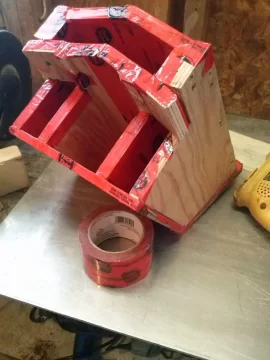

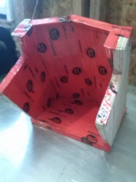

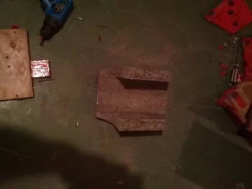

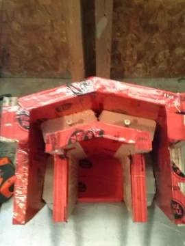

Put some pictures up.Took forms of the tunnel this evening,quite pleased how it turned out.I used 3/4 pine,3/4 plywood and 1/2 plywood for forms screwed together.The cement side can be tuck taped as being built.The inside form is removed first and built slightly tapered so it will slide out after it is poured.These forms can be reused again.Looks like we are going to see some warmer weather soon,we need a break.

This cement Plico Tuff Mix is what I used,added stainless wire at 1" lengts and water to the mix.Time will tell if it is tuff enough.The curing process would be very important also. The Jet Stream is still one of the most efficient wood furnaces ever built.When oil prices went back down in 80's lead to it's demise.Weather here now up to +4 and looks good all week,nice brake from the last 3 weeks.
Like your form. Very simple and very reusable.
I wanted to build the form so I could make more tunnels.My main refactory is 4 years, furnace 19 years old so maybe I can coaks another 7-10 years out of the old girl.I see now that my cast iron door is wearing on the hinge stops.It does not stay vertical when opened, will have to be built up with some weld.Nice morning temp.+8 ,snow and ice melting.
