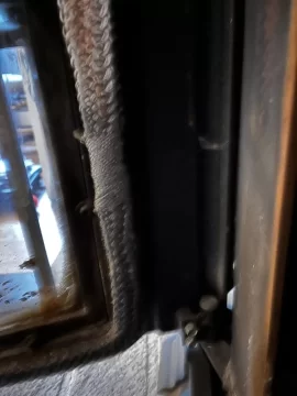

Hi Everyone,
I’m going to replace my door gasket before the season starts up for us. Current door gasket is 8 years old and very hard and compressed in areas.
I feel pretty confident in doing it for the first time, but I had a question about how to join the two ends of the gasket together. The OEM that is on there now has the ends wrapped together - which I won’t be doing.
Is it better / easier to bring the ends together in straight line right into each other or to meet in a corner and where they would meet perpendicularly?
I’m also planning on joining the ends near the bottom corner near the hinge where the pressure will be tighter so the ends are squeezed a little tighter into each other than if they met near the latch.
Does that seem like a good plan?

Thanks. I ended up butting the ends together intending to get them on the hinge side. Of course I did a mind fart and starting putting it in so they would meet on the latch side…<>
I really wanted to pull it out and start over but I figured I would just end up making a mess of things. It seemed to come out pretty well though and the join area is pretty good for now.
I’m glad I changed it. Was on the fence about whether I really needed it because I always passed the dollar bill test. The old gasket came out clean just by a very gentle tug. There was only a four inch area where there was any cement stuck to the door where I actually pulled on the gasket to get it out. Other than that the door was pristine and clean. All the cement came out with the gasket.
