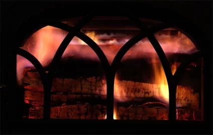

My Oslo in secondary burn action.........Video and Picture

NOT trying to compare the f3 with tthe oslo, but where do you have your air setting when you have burns like the one in the video. Once i get a rolling fire i cut the air back to almost closed over about 10 mins or so. just trying to say that i don't just shut it down right away. Maybe i am not gettin the sec burn due to not having enough air flow??

My BIL has a really nice Ivory enamel F3CB and when I visit, I sometimes run the stove for him. It runs very similar to my Oslo .....only diff is the draft control is on the top right, its smaller and the burn tubes are triangular.
I treat both stoves the same, I leave the draft control wide open till the wood is charred and the temp is above 500+ (depending on the load and temps outside)
Then I shut the draft control down 75% or more.
Can you easily get your F3 up to 500-600 ?
