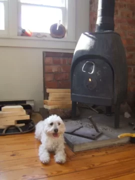

We used a Jotual Combifire #1 for 7 years. It came with the house. We just replaced it with a new stove this season.. This picture shows how it was installed. I don't know the specs for installing it but the stove body is hot on all sides so it should have good clearance from the walls.

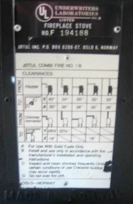

Underbitte, welcome. That is quite a find, it's a serious heater. You should be able to find a UL clearance plate on the rear of the stove. The stove needs a lot of room. You can reduce the clearances by wall shields, the best being by installing an NFPA 211 ventilated wall shield and using either pipe shields or double-wall connector pipe.
If you can get a sharper shot of this UL label from your stove, could you post it here for others to find?
