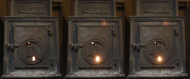

Opening the air all the way did seem to send a lot of heat up the chimney, and the stove was cooler then as well. Here's a sequence I shot a few years ago that shows what happens with a good fire in there as you stop down the air. Each time I closed the air halfway, the fire intensified and the intake velocity increased. It's hard to tell through the bottom opening because the camera sensor blows out the highlights beyond a certain level, but the opening at the top shows how the fire got more intense with each reduction in the opening.
That doesn't mean it's getting much less air, it's just coming into the stove at a much higher velocity. You can hear it whistle real hard at a certain point, and that seems to be the sweet spot. The increased velocity creates a lot of turbulence inside the box, which means better gas mixing and much cleaner combustion with less excess air. At a smaller opening (about 3/8" here), you can take a pinch of fine ash and sprinkle it it a few inches away from the inlet and watch it arc into the stove from the pull of the draft. Try it, it's fun.
