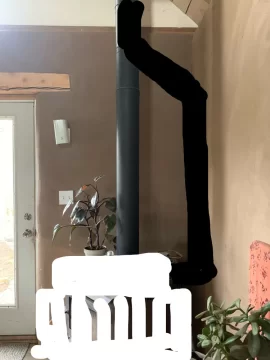

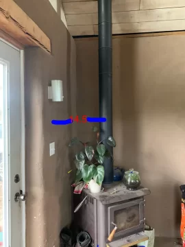

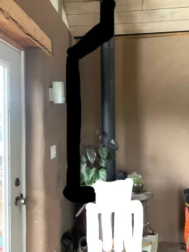

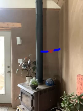

Thanks for the response. I’ll post pictures of stovepipe clearances for with current stove installed. The next two pictures are doctored with my ideas for pipe placement. The 118b has three options for pipe placement. Back or on the right and left sides towards the back. Unfortunately the stove is still in the back of my Subaru. Waiting for a couple strong friends…

There is no window on the F118. What about placing it parallel to the right side wall and going straight up from an elbow (or tee) on the rear?
PS: My first reaction was concern about clearances. I had to remind myself that this is an adobe home with non-combustible walls.

I can place it parallel to the wall if need be but my house is very small and i'll have to scrap my dining table if i do that. if the last photo with my drawing is spacially possible, will that pipe configuration draw?
Yes, it will still draft. It might take a little preheating on mild temperature days, but the stove is not as fussy about the draft as modern stoves are.
With a good fire burning, this stove is very radiant on the sides. It's not shielded with a cabinet jacket like the current stove. How close will it be to the dining room table and chairs?

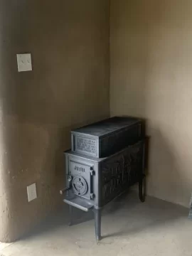

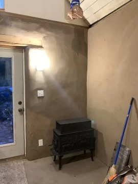

It turns out that the stove doesn’t take up as much space as I thought it would in that corner. I don’t think I can go straight up from the back but I think with a little tweaking, I will be able to have it exit the rear.
I’ll post another pic when I have it moved into place and get the pipe back in. When in position I think the stove will be a foot from the wall and about three and a half feet from the dining table.

Play with the options. Maybe try placing it at a 45º angle with the elbow or tee on the back coming up to an offset.
