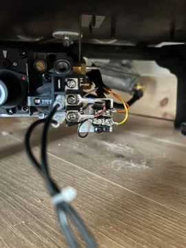

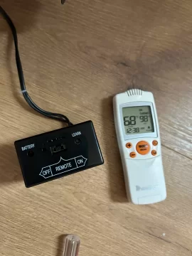

Hey guys I’m having trouble getting my durablow remote to work with my stove. I followed the instructions to sync everything up. Stove is in STAT mode. Any ideas? Thanks

It looks like you don't have one of the switch wires from the remote module connected properly. One of them should go to the bottom terminal(marked "TH/TP"), and the other one should be connected to the top terminal(marked "TH").
