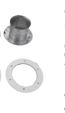

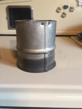

I have a 20 year old Jotul 3 natural gas stove. Was moving the stove from the first floor to the second floor and damaged the transition pipe on the back of the stove connecting to the Duravent pipe. Can not find a parts schematic for the stove to determine what part I need. The pipe is 4" wide and 4 1/2" long and a mounting lip with four holes. If I can not vent the stove its a brick. Have attached an example photo of a similar pipe and the actual broken one.

Tried the local brick and mortar store for the part and they could not find anything.s The part looks the same as the one on the newer stoves. Only difference seems to be the number of mounting holes.

Have talked with the local brick and motar store and about 10 different Jotul dealers. Jotul tech says this part is available, but the cost from Jotul is prohibitive at $360 plus shipping and tax. Some of the new Jotul stoves have a similar part, but not sure if the length is the same at 4 1/2".
Is there a Jotul near you that will let you measure the part
on one of the newer model stoves for confirmation?
Left the old part with the local Jotul dealer a few days ago and have heard nothing since. Will go back next week an see if I can get a measurement. The part I need to measure is #129781 and the gasket is 129774.

I had the same problem you are having moving a Jotul 3 from downstairs to upstairs and broke the same transition adapter pipe. Could not find the part anywhere. Finally called tech support at Jotul and the part was discontinued. They did at the time, several months ago, have a couple of the adapters in stock. Unfortunately, the price was over $200. Finally gave up and sold the stove for $200 locally. Replaced the Jotul with the Valor Portrait stove.
