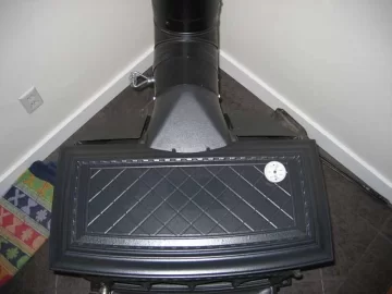

The reason I asked about extending the front part of the hearth is that the stove can be easily be changed to rear-exit. Then you can move the stove forward and add a double-wall elbow to the rear-exit to connect with the existing piping. Why? It will move the stove into the room about 9" which will increase the sidewall clearances nicely. Here's a picture of our rear-exit setup. Note there is a draft damper too.
