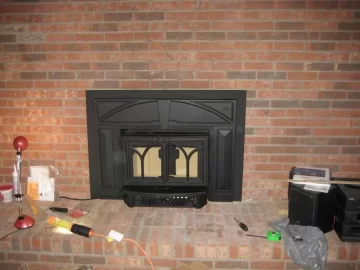

I installed a Jotul C450 Kennebec last month.
Had a similar issue, 1" gap on both sides between insert and fireplace opening.
Did not like neither the size (extra 4" all-around) nor the price of the add-on "surround extension" which Jotul offers for this model, and decided to fabricate my own.
The photo shows the result. 2 pieces of steel studs from Home Depot, appropriately trimmed and the pieces riveted together, a little stove cement, a can of stove paint spray, and it's done. It bolts to the original surround where the "extended surround" would have been bolted onto.
My wife (who is a very picky person on the aesthetics side) loved it! I like it too.
Get creative, or buy what Jotul has as a surround extension for the Rockland.

Well done IK, that looks like a factory install. I had to do a similar surround addition when we had the pellet stove and used 4" strips of black painted sheet metal for the extension.
