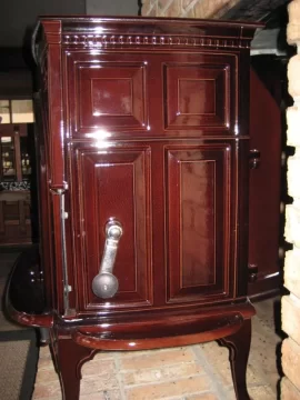

I recently bought a Jotul 600 F stove and I noticed a quirk with the side door handle latching system. Here is a photo of what the door handle looks like when fully shut:

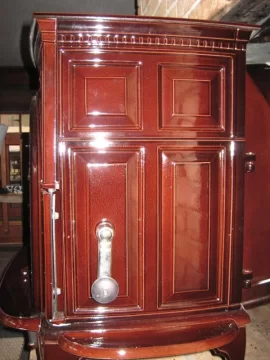

After I close the door and latch it a few minutes later I will here a small noise and the handle is in this position:

The door is shut fairly tight, but not locked down. When I push the handle shut I can feel increasing pressure up to the point shown in the second photo. The last few degrees pull the handle tight against the stove door and I can feel it come to a dead stop. However, it feels almost like it is on a hair trigger and the slightest touch will make it pop open that small amount shown above. I talked with another Jotul F 600 owner on this forum and he reports the same experience. I called the stove store where I bought my Jotul and asked him if he had any experience with this and he said he hadn't noticed that happening before. I asked him to check with his Jotul representative and see if he could find out how to remedy the problem. I haven't noticed it causing a problem with my fires and the door is still latched, so it's not likely to pop open all the way since gravity holds the handle from opening any further. I haven't been able to try the dollar bill test yet due to burning the stove 24/7 since installing it last Wednesday. Any other Jotul owners have this problem? If so, have you figured out how to remedy it?

Hi Nick! Like i told you earlier, I have the same issue, although mine doesn`t pop. It just slides back 1/4 to 1/2 inch, pretty much like in your photo.

Check the bolt/screw that holds the piece of steel inside the stove that the latch catches on. Maybe it was not tightened down enough from the factory?
