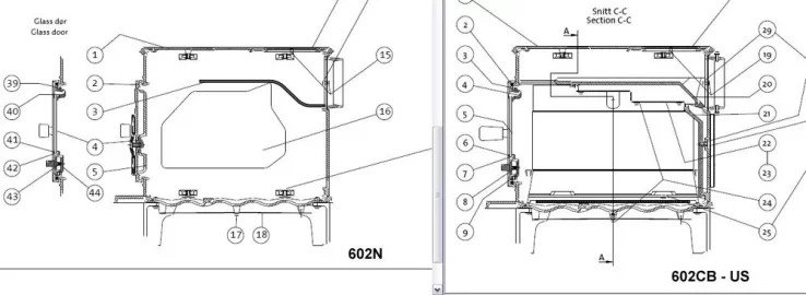

The stoves are not the same. The N model does not have the secondary air manifold and chamber that is in the US CB model. It's a simpler stove that should be immediately apparent if you look in the firebox at the underside of the baffle.
That said, the N model is a great little stove. What is the asking price? If $300 or below and in great condition (particularly the interior burn plates) then I'd go for it.

Maybe that's the case in UK, but the two N’s I’ve seen here had the 2ndary air system and the same glass-front door as the CB...
Yah, I took the schematic from the UK site that you posted. Odd that same stove would have two designations in the US. What's with that?
Marketing, maybe? I think some other Jotul models got the CB designation added to their name without any changes made, also.
