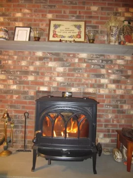

We have a raised ranch and use the Castine to heat the roughly 1,200 upper level - does a really nice job. We almost went with the Oslo, but on the advice of the hearth shop owner, decided not to. He felt with the Castine, we would run it hotter. With the Oslo, we would be dampening it down and perhaps creating too much creosote. Hard to tell from the picture, but the hearth is 6 feet wide . PS - we used to have the Fisher Mama Bear - when doing a re-build on the chimney and pulled the stove out, we found a crack in the back of the stove. Could have tried welding it, but after 35 wonderful years with the stove, felt a retirement in order
Nice looking set up.

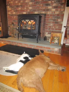

We don't have a damper, but I learned where the air intake is underneath the stove in the center rear. It is the size of a golf ball I would say. In am emergency, where you would like to close off air intake completely, have ready near the stove, a balled up aluminun foil ball the size of the intake hole so you can plug it up. (Safety tip I learned form some people on this site). Our pipe goes up a lined chimney. We have no trouble with draft at all, but I am thinking of adding a rear heat shield, not so much for added protection, but to have the heat radiate up between the stove and the shield rather than heating the the rear of the stove & chimney that faces outside.
