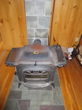

Here's a pic of my current setup. The 6" connector from the exit to the thimble is dead level even though it doesn't look it in the picture.

if its an inch off why not trim the legs an inch or possibly not use the legs at all and set the stove on the 4 points on something nice?
I didn't know that was a possibility (cutting the legs).
Was *hoping* that the F45 Greenville short legs would fit on the Castine since the former offers a greater drop when placed on the latter and it would end up being exactly 25" to the top of the flue.
