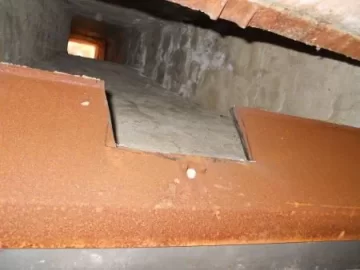

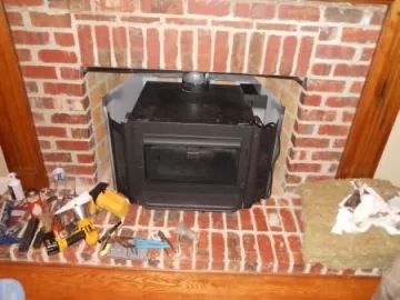

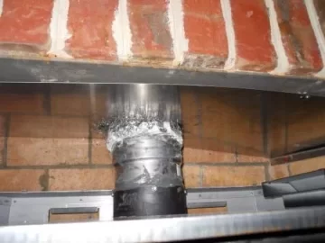

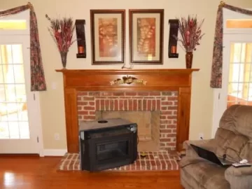

Ok uploaded a few pics of the install tonight. The pictures are of the delivered unit, the damper cut away, and of the unit sitting in the opening with block off plate and liner connected.
The block off plate is loose right now so the inspector can look above it then I will screw it back up with roxul above it.

Looking good.
One more thing I did after a couple years of it annoying me. I painted the inside of the top casing and the 2 deflectors black with stove paint. The gray really stands out and looks out of place once it is all together, and to me stuck out like a sore thumb. So I painted it. If your going to consider that, do it before you put it all together and get it in there. Its a real pain in the arse to do afterwards.
