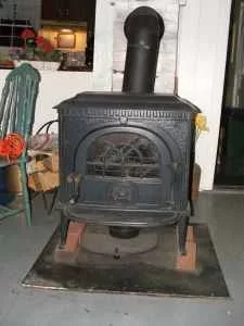

If it has no catalytic converter - you can tell because it would not have a bypass......any with a cat would have to have a flue bypass, then it is probably somewhere from 1983 to 1990.....
Later models were still #8, but had other numbers like 8TDC or something like that - should still be visible on the metal label on the rear.
The pic enclosed - from craigslist - is the older non-cat #8 - not a bad stove at all, but pre-epa and more than " a few" years old.
