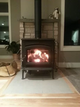

We built a new house with an F50 - so far it's been heating about 2800 sf regularly....below is a pic.
Love the responsiveness and long burn times with the stove. As for the ash pan - the first time I went to use it learned one lesson - don't open the ash pan door without opening the front door - sounded like a jet plane taking off! As for the ashes behind the pan - what I've been doing is letting the stove cool down (usually when I get home from work) - I then work the ashes around the stove letting them fall around the ash pan. This way when I open the ash pan there isn't as much to fall down while it's out. Also, I need to make sure to unload it at least daily.
And yes - rake the red coals to the front!
Had a few problems with black glass but not the stove's fault - I split what I thought was a downed ash tree - but it's not ash.
Side note - we don't have the blower for the stove. But when we built the house I did put in a separate duct through the floor beams - it pulls cool air from the far side of the house and blows it out behind the stove. You can't see the vent unless you look for it. But I put it on a variable speed switch and if the house is cold and we crank it up it heats up quick. Otherwise we leave it on low and it moves the heat around nicely. Draws about the same as a 60w light bulb - and you can't hear it.
I would recommend this stove to others.
And one more thing - we have the OAK on ours. Does anyone else have this? While the stove does draft well with it, if I do not cut the air down before trying to reload I get smoke spillage - not sure if this is related to the OAK or not.
