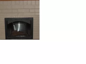

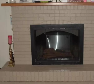

Thanks for the reply Rick.....finally I was able to figure out how to shrink my pic and post it on here so everyone could see what im working with. Thanks all....... keep in mind while looking at the pic the hearth is only 16 inches deep...

Howdy Larry. Can you add a shot that is further back? This one doesn't include the hearth. I suspect that if you put in a stove instead of an insert, you will need to extend the hearth for sure. It needs to extend at least 16" in front of the stove door. Is that possible in the current setup with the Jotul F100?
What are the dimensions of the current fireplace? (front at top of arch, front at the sides of the arch, front width, back top width, back bottom width, depth at top, depth at bottom).
How far does the hearth extend in front of the fireplace? How far is the mantle from the top of the arch of the fireplace?
You're doing fine. How far does the current hearth project into the room from the face of the fireplace? Looks like it's right about 16" which would mean some sort of hearth modification needed.
Yep, that's what it looked like to me. I suspect some sort of hearth addition will be required if the stove projects from the fireplace front. You'll have to decide what the primary purpose is, casual fire viewing or real heat. Our neighbors have the Lopi Answer insert. It's a pretty small stove. They use it mostly for ambience, but I don't think they use the blower.
