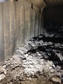

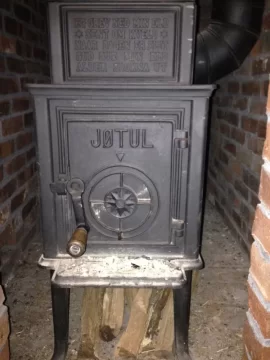

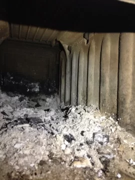

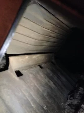

Hi everybody, my name is Doug and I recently purchased a home that has a wood stove I believe to be a jotul F118. I think this website/ forum is awesome and I've been reading quite a lot. I've included some pictures to help here, please let me know if they're not good enough. The outside of the stove looks great, no cracks that I can see. The inside plates (side and roof plates- sorry I don't know lingo yet- also look good to me, but I want to make sure before I start burning). This house was built in 1983 and the stove was put in that year. The previous owner was a real weird guy but super anal and was very meticulous about maintaining things. I'm hoping to get some feedback on how this stove looks and what I may need to do prior to the winter. Thanks!!

Yes, normally I put down about an 1" of sand in a cleaned out firebox. A good ash bed will also suffice.
Bringing this thread to life again. I've tried to read everything I can find that is posted on this stove (the old Jotul 118) but I'm not sure I'm finding a definitive answer on this: So the stove has the main box where I put the wood, above that is an interior metal plate (a baffle correct?), and then above that is another smaller box. What is the purpose of that upper smaller box above the baffle? I've read that maybe it's a compartment to burn off gases etc? if this is true, is there a specific way I should burn that would maximize this capability?
Additionally, do I need to clean this upper box at all? I'd really rather not take the stove apart if i can avoid it as the stove seems to burn great and I don't want to ruin a good thing.

The upper chamber is a heat exchanger that the flue gases are routed through. It definitely should be cleaned. Especially if damp wood was burned.

If I'm reading that manual correctly it's referring to that upper chamber as the "heater" and it says to remove the top lid order to clean it. Dang it. Begreen, have you ever actually taken one of these apart? are there screws or glue that need to be undone/unstuck or is this a lid that I can literally lift off and then place back down on the stove once done?
The top lid lifts off.
Yup, top lifts right off. I believe your stove has a double bottom plate and does not require sand.
Thank you. Lifted it off and cleaned out creosote buildup/ ash a few hours ago. All clean and ready to burn. Way easier than I thought it would be.
