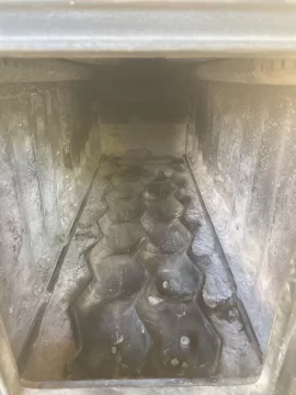

Here is the firebox of the used Jotul, seem to be in fine shape?

The CB stands for clean burn. The firebox looks good, the secondary rack sits above it. You can see the tubes running lengthwise on the upper sides. The lid is removable but the shipping bolts may still be in place.
Ok I am going to contact the seller and see if he can remove the lid and check out the secondary racks. Thank you!

Most importantly it should have no cracks in the stove body including around the flue collar.

I didn't notice any cracks at all, but I will double check. I've been doing a ton more research online and am concluding that I would have to spend about $400 on heatshields for the Jotul to get the clearances I need/want....so I'm thinking it might be smarter to go with a brand new stove. Currently looking at the Drolet Deco Nano, which seems to have pretty good clearances but its a bit difficult to decipher some of the info in the manual.
