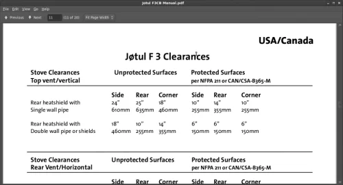

The way I read the spec for the stove diagonally centered in the corner, with a rear heat shield and double-wall pipe top-vented, the clearance is a minimum of 14" from the rear corners to the wall. But it does not hurt at all to exceed this. If you have 21" that is great.

Like BeGreen says, the rear stove corners have to be 14 inches from combustible surfaces with double wall pipe, 18 inches with single wall. My stove corners sit 14 1/2 inches from the walls and my pipe is 23 inches from the walls. If yours is only 21 inches, you want to make sure the corners are at least 14 inches from ANY combustible surface.

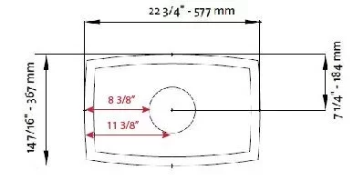

Thanks, that's why I wanted to see a picture. I thought you had 21" clear from the corner of the stove. Measuring from the pipe makes a big difference. I think you may be too close and will need to move the stove forward. The stove is 11 3/8" to the centerline and the center of the pipe is 7 1/4" from the back. That puts you right at the edge of too close. (Check my math -> 11.375 - 3 = 8.375. 21" - 8.375" = 12.625') If that is correct that is 12.625" at the middle of the stove. The back corner would be even closer to the wall.
If that is so, don't panic. The stove could be rear-vented to an elbow which would bring it forward by plenty enough to give you plenty clearance. Or two 45's could be put together to make an offset. Otherwise the wall will need to be protected to reduce clearances. I would make a cardboard template of the stove so that you can get measurements exact.
yes thats why i was was wanting to know the definition of "side" of the stove was. When I asked my salesman he looked at the manual and was also unsure. He ended up calling Jotul and they said it was the side of the pipe. I set it up that way. I can rear vent but according to their definition that would be too close. totally confused now.

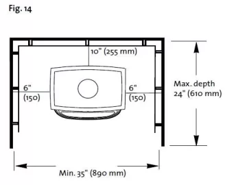

I'm not understanding the salesperson's response either. The double-wall pipe, protected wall clearance is 6" from the side. How could that work if the pipe edge is 8 3/8" from the side? (Well more like 7 7/8" accounting for the double-wall jacket.)
The alcove clearance diagram clearly shows this measurement is from the side of the stove to the nearest combustible surface, not the pipe. I find it hard to believe that Jotul said from the pipe as this installation has been described unless there is horizontal run of pipe that might need greater clearances.
