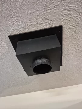

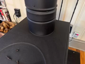

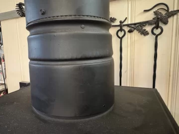

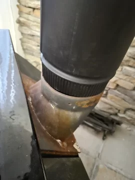

On the advice of my chimney guy, I got a Selkirk telescoping double-wall stovepipe (this one: https://www.ebay.com/itm/313773554737) to go between my Hampton H300 stove and the ceiling support box. The distance is less than 60", so the pipe is plenty long. My confusion is that neither end fits the stove, and I'm not even sure which way the pipe is right-side-up. I know very little about all this, so please tell me like I'm five: What adapters do I need and how do I put this together? Or, have I got the wrong pipe entirely? Pics attached of the support box and the top of the stove, showing one end of the connector pipe (probably the wrong one haha).

Selkirk DSP is odd, with the outer wall crimped end. That faces up, toward the support box. It should fit outside of the support box's crimped stub. Selkirk sells a decorative band to cover the crimping on the outside of the DSP. What is the fitment like on the stove flue collar with the other end of the DSP stovepipe?

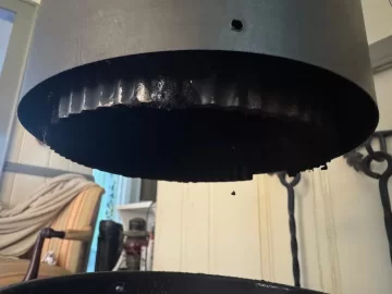

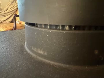

Wow, that is odd. Thanks for the tip! The crimp-to-crimp connection does work, even though it doesn't doesn't look like it should work. The decorative band was included with the pipe, though I don't know whether we'll bother with it or not. Attached is a photo of the lower end. Guess I need some kind of double-ended crimp connector here?

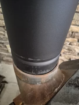

What is the ID of the flue outlet?
I had a similar problem. That adapter should work. The crimp slides between the inner and outer sections of the DSP, so the inner side of the DSP is still “down”.
This may work, measure first. Again, the outside crimp on DSP points upward.
The ID of the stove outlet, near as I can measure, is about 5-7/8". I'm confused by this adapter diagram. Is the adapter supposed to fit over the stove outlet, or into it? Is it double wall and the lip of the outlet goes between the two walls?
It's double-walled. The parts diagram indicates the dimensions for the inner sleeve that goes inside the flue collar and the outer jacket that goes outside of the flue collar.
