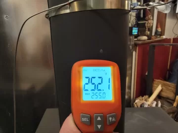

I had to put a new battery in my IR gun this morning. I never use it anymore, but you had me curious. I use an in-pipe thermocouple, similar to what stoveliker recommends.
I have maintained a fire at over 650 degrees, as read by the thermocouple, for over 30 minutes. For your reference, this is my double-wall surface temperature at an internal pipe temperature of 671.5. Different stove pipes measured at different points will probably give you different readings.
I have the blower going, and on my stove that blows across the stove top and the base of the stove pipe at the stove collar. I imagine if I did not have the blower going I could get a higher reading where the stove pipe connects to the collar. This reading was taken maybe 9 or 10" above the stove top. The thermocouple is at 18".
The surface temperature of the double wall is not very useful for helping you run your stove, but I agree with stoveliker. 400+ is running it too hot unless you are checking temperature right at the stove collar.

In addition, FYI I have an Auber digital internal probe, right now it reads 625degF, my IR gun reads 200 on the outside of DVL double wall. The internal temp has been stable for 1/2 hour
