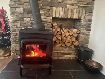

Looking for anyone who has experience with this stove and can tell me how its working out? Looking for burn time info with different woods, I burn a lot of Aspen but also have better hardwoods for colder days. I've read the firebox is about 2 cu ft, anyone have the true dimensions? How hot does this thing get, is there decent radiant heat or mostly just convection? Thanks
Anyone know what the lead time is for Jotul USA these days? I know VC is 60+.
My Christmas present! I was going to wait til next season since the lead times were 60+ days but a local dealer found one and I grabbed it for $1999. They loaned me their forklift cart and I slid it right onto the hearth replacing the 602.
Only a couple days with it but I like it. I haven't had to push it even with the Blizzard we had the other day. 3/4 loads pretty much all I need to keep the cabin mid 70's.
The stove seems very controllable, I was a little worried since my 602 liked to run away once in awhile on cold windy days so I was thinking the F45 may do the same but so far it's drafting fine on my 22' straight up chimney . Once my internal pipe temps are up to 400-500 I can shut her all the way down and she'll stay there steady for hours with a nice looking slow burn and clean glass.
Stove top temps run 400-700 dead center of the stove a little less in the top corners where Jotul recommends a thermometer. I'm betting a 10+ hour burn should be no problem with a full load of good hardwood. I'll be happy with an 8hr burn or 3 time loading schedule per day.

Looking good! It should burn quite differently than the 602.
Nice that you found one so you can use it this year. You will have to keep us posted on how you like it compared to your previous stove. Be interesting to see what your burn times will be. Looks like you got it in just in time because it looks like winter is going to be settling in now.
Reactions: Todd
Thanks, yeah it definitely burns different than the 602. Takes a little more time to throttle down to a low burn like 15-20 min verses 5 min with my 602. The wife also likes the better fire view and will be easier for her to load and operate.

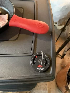

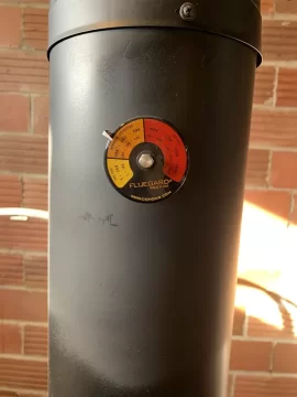

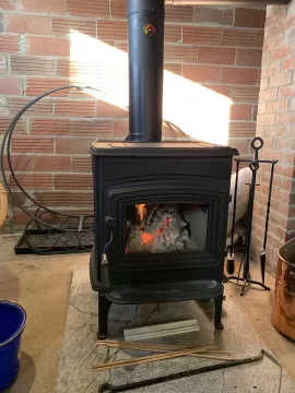

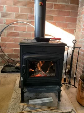

I reread your posts and have now got a flame going that I followed along with your first post on building the fire. It is running at 500deg at the stove pipe, and the lever at the bottom fully closed now.
I filled the box this morning and got it going as I did have a scant amount of coals left over from last night. This mornings fire burned down too fast I thought. I had the damper 1/2 open, so I may have burned through the wood too fast. Anyway, about an hour ago and following your post, if filled it 3/4 with hardwood, walnut and ash, and after about 10 minutes was able to close the damper all the way down, as there was still some burning wood from earlier. It still looks good 40 minutes later and is at 500 at the pipe.

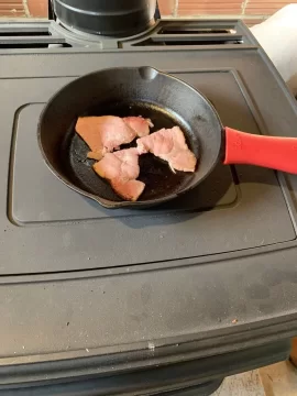

I took some thanksgiving ham out of the freezer and warmed it up on the stove. It really heated that pan of ham up fast and brought my DH downstairs because of the smell ;)

Looking good Enduring. Yeah, half air for me will also burn too fast and hot with a full load. The Ham looks good, I think I'll do the same with my Christmas dinner leftovers this evening. Keep me posted on how your stove perfoms. Thanks
