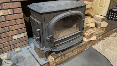

Hello everyone, I am new here but have visited here before to read. What I have now is a Jotul F500 I bought in 2016.
This sits just outside the fireplace on the stone hearth. The exhaust pipe goes out the back then up thru the chimney.
Fully lined and insulated 6 inch diameter. It is a interior chimney with stove on the first floor going up thru the roof of a two story house.
What I want to ask all of you is what will I gain by going to a Blaze king princess insert? My house is 2400 sq ft built in 1978 with normal insulation.
I have oil fired boiler as my other heat source. Thank you for the help.

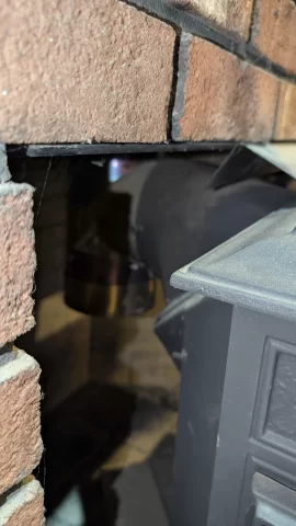

I was thinking I would not gain much for the money. I am attaching pictures. I was hoping for longer burns but I realize this stove has been good. The picture for the back of the stove is a little blurry. It is a tee with a clean out at the bottom.

While you can sell the jotul, if the burn time now doesn't make your life impossible, I'd say it's not worth it to change.

Do you have a damper on the current setup. 20’+ feet of insulated liner really must draw.

EbS-P I have considered more insulation in the ceiling. Walls would be difficult. They already have fiberglass in them. Some windows upgraded. No damper and I think the chimney might be close to 30 ft because it sticks out of the roof about 5 ft.

It looks like the set up for the f500 is about as good as you can get it. No fans needed. Good for power out days. And that is a very good stove. If you want longer burns concentrate on perfecting your wood and wood loading and air settings. That stove is definitely worth more than $1,500.

And likely you'll need to add a key damper indeed at 30 ft.
That may give you significant more heat in the room (and thus lower burn rates, and longer burns).
A flue probe is $35, and a key damper is $25 or so?
Worth it imo.
Did you air seal where the liner enters the chimney?

Thanks everyone for your advice. Yes there is a block off below the old smoke chamber on the fire place that seals it off from the house.
I will get a probe and get a damper. I would like to check how much draft I have. I have come to the same conclusion about it not being worth it to change stoves. It would be different if I had a bad stove. Thanks again.
