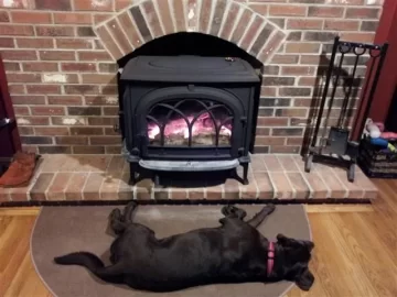

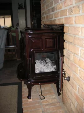

I have my Jotul F600 sitting on my hearth extension that is 17" deep and the front legs of my stove are sitting two inches back from the front edge of the extension so that I can have the rear legs sitting inside my fireplace opening. I didn't want my extension to carry the full weight of the stove since the extension sits on my wooden subfloor while my fireplace sits on a solid foundation in the basement. So, with a 16" extension you would be able to position your front legs within an inch of the front edge and basically have the same set up I have. I can open my side door about 85 degrees and have no problem loading through the side door. In fact, I never open the front doors except when the stove is cold to occasionally clean my glass. Here are a couple of photos of the side door opening:

Hey nick that is a very very beautiful stove. If you don't mind me asking what is the price of a new enamel f600 I love that color! Thankyou for pics I remember reading your post but thought you had a larger hearth, so that is reassuring. I have come up with a possible stover purchase/idea that I will post about after a bit. But my end goal is to have something that looks that nice as my fireplace is the first thing you see and the focal point of the house

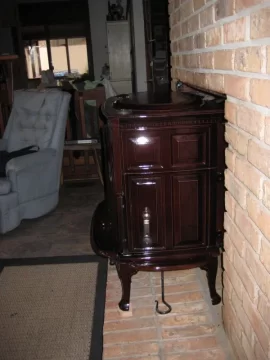

I have a similar setup as Nick, only mine is an F500 not a 600, I can get my side door open about 80 degrees and its more then enough for loading the stove. I never use the front door to load only when cleaning the stove.
