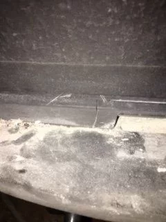

Jotul f600 cracking problems
There is a draft damper on the stove pipe. If it is over 30 degrees I pretty much have to have it completely closed to somewhat control the stove. I can only put a few logs in at a time as well. Any idea how I get the base plate replaced? How much should that cost? I am not sure my dealer would provide that service. Thank you for your expertise.

I replace all the door gaskets and the ash pan door gasket as well last year. I have never replace the ask pan gasket itself though. I just re-tightened the 4 bolts on the ash pan. They were not loose. I removed the front tray and took another picture of the crack.Link Removed

Boy you've done all the smart things to fix this.
