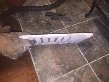

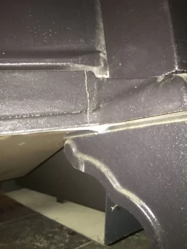

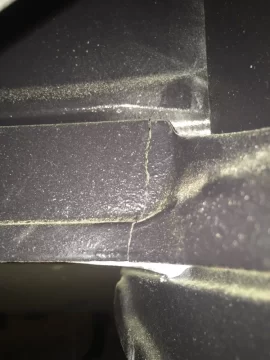

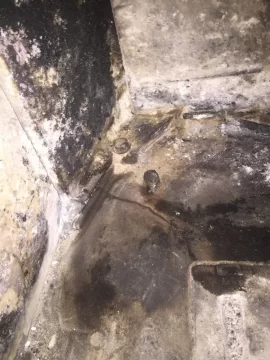

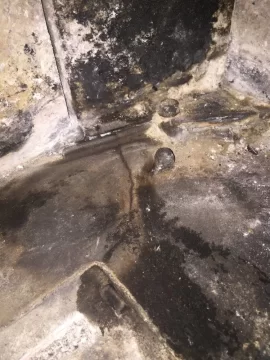

ok, my boy is helping dad put these pics on so I hope it all comes in ok.
[Hearth.com] Jotul f600 cracking problems [Hearth.com] Jotul f600 cracking problems [Hearth.com] Jotul f600 cracking problems [Hearth.com] Jotul f600 cracking problems [Hearth.com] Jotul f600 cracking problems
ok, the first two pics are of the crack inside the stove....the second two pics are of the crack on the outside of the stove and a pic of the nice flat grate if that means anything!? What is everyone else's opinions. I hate to hear that Central VA Heat, my wife and I have been very pleased with this stove until now and to hear your disdain with jotul further exacerbates our predicament! If I may, what was your problem with their customer service? Hopefully I will hear one way or the other tomorrow so I can lay this to rest
I can see why Jotul thinks this is the ash pan door issue. It strongly resembles the ash pan open cracks we have seen reported here. The grate will show no stress or issues in this case. It usually shows up when the interior grate area of the base is forced to heat up very rapidly while the exterior of the stove is still cold. FWIW, I don't think that a loose side plate has any relation to this crack. Check to see if there are any airleaks in the ash pan area.

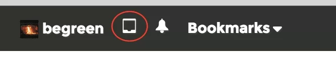

Start a conversation by double clicking on what looks like a cell phone icon in the upper right. (circled in red)
Then click on the "Start a Conversation" button and list stovelark as the participant. Copy a link (the url) from this thread and paste it in the Conversation thread to point him to details we have discussed.
