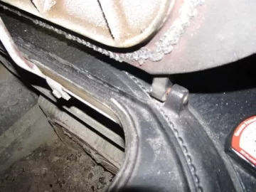

Hi guys need a little help determining what size gasket and where to put it. The top loader led needs a gasket.The prior owner had glued what looks like a 1/2" rope gasket to the led. What is the correct size and style of rode gasket should be used? Does it glut to the led or the channel around the opening? I see where McMasters has tight brad fiberglass rope.

Did you ever get an answer to your question. My manual says I should use a 1/4" gasket, but it doesn't say whether to glue it to the channel in the lid or to glue it to the channel in the top of the stove around the opening. Both channels have old cement and bits of gasket.
It would be 1/4" and be glued into the channel on the stove top I would sure think. I've never seen a top loader that didnt have the gasket glued to the top.

Thanks guys. I used a 1/4 gasket in the channel. But it still draws air and didn't pass the dollar bill test. I'll keep working with it.

The photo you posted shows the old gasket glued to the surface of the lid, not the top part of the stove. It seems like the channel in the top part of the stove is too narrow for the gasket. I wonder if that little channel is a seat for the unglued portion to sit in. I've looked online and seen images of gaskets glued to either surface. It seems like if you glued it to the top of the stove, you would ding it every time you loaded wood from the top. It's strange that the Jotul manual doesn't say which surface to glue the gasket to.

Your gasket should be glued to the top of the stove, not to the lid. I suspect some people have tried to glue it to the lid, because it's prone to being easily damaged in its correct location, but it would be very difficult to get it attached to the lid in a way that guarantees the lid will sit right for an airtight seal.
The choice of gasket material and the application technique is critical, for getting this particular gasket to seal, since the only pressure on it is the relatively light weight of the lid itself. Clean all old cement from the lid and the channel in the stove top, to get the gasket to sit properly in the channel and seal to the lid. Use 1/4" braided gasket (not woven), and smear a small amount of cement into the channel (just enough to hold the gasket), and use masking tape to hold the gasket as you work your way around the perimeter of the opening. The gasket should be relaxed, not stretched, and the ends should just slightly overlap (so as to account for the small amount of fraying you will surely see) in the rear center, behind the push rod that lifts the lid. When installed, the idea is that you want the gasket to be able to compress into that channel, so it should not be filled with globs of cement.
This is not a difficult job, but chipping that old cement out can be a real PITA. I use a couple of awls and junk sharpened slotted screwdrivers.

In general on any stove I have ever seen if there is a channel on one side of mating surfaces, the gasket always goes in that channel. The fun ones are like my door gasket, flat.......Oh how I miss my old Sierra.

JeffView attachment 119307
I've owned my Firelight 12 since new in 1998 and my gasket came attached to the top of the stove, not the lid. The same was true of a second Firelight 12 that I owned and have since replaced with the Progress. I'm a 24/7 burner and have only had to replace it twice since then and no tape required to keep in place while positioning..
Thanks Joful for the detailed procedure and the input from the rest of you folks. I did attach to the channel but use woven 1/4" and it didn't seal well. I will replace with braided gasket, NOT stretched tight. After several unsuccessful tries at this I had come to the woven set in loose. This was going to be my next attempt. Nice to know I finally got it. Like most things we learn or at least me, I do get there after several tries. Thanks again. I'll post back once Ive change gasket.
Yep, you're headed in the right direction. You'll note they specify braided (not woven) right in the Jotul manual, for this top load gasket, and I think for all their gaskets (except maybe rear burn plate).
