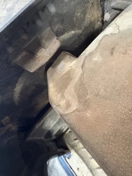

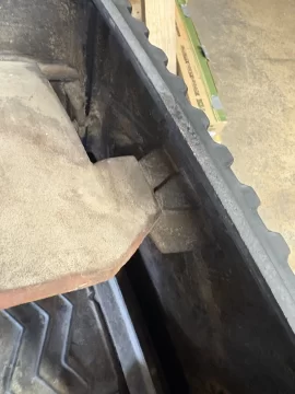

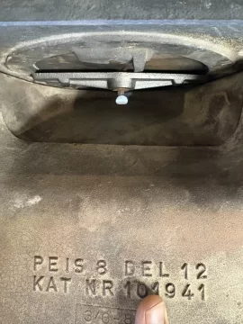

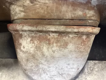

The top baffle, can’t seem to get it to sit correctly. Exterior side pieces have a single ledge towards the top. If I set the curved top baffle in flush with the rear lower plate lip, the baffle sits up higher than the ledges. If I sit the baffle on the ledges, then the bottom lip of the baffle doesn’t seat into rear lower plate lip. Anyone have pictures of this installed with their top off? Thanks

Back lip seated

Below side flange

Back lip sitting above, no longer flush

But now wings of baffle side on side flange
Could be the baffle and or exhaust collar is a little warped. They take a lot of heat and don’t last forever. Just a little warpage can make these cast iron parts not fit tightly. You may be able to grind parts of them for a better fit? Are new parts still available? If not maybe a local welding shop could make a steel baffle?
