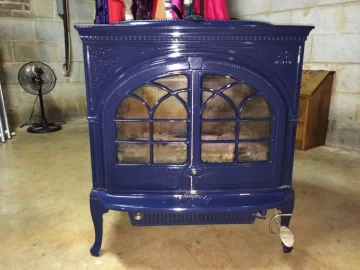

I just purchased a Jotul Firelight 12, blue porcelain. The owner says he only used it 5 times...but I'm not sure. Both sides, toward the back, have paint that is peeling. Is that from overfiring...or not curing it properly? Also, I purchased it for $400...we cracked the glass on one of the doors moving it. I'm worried I'm going to have to put a bunch of money into it. My last stove was a Fisher Mama Bear...have no experience with a Cat stove. Thanks for the input.

[Hearth.com] Jotul Firelight 12 [Hearth.com] Jotul Firelight 12 [Hearth.com] Jotul Firelight 12 [Hearth.com] Jotul Firelight 12 [Hearth.com] Jotul Firelight 12 [Hearth.com] Jotul Firelight 12
Here are some pics...I haven't cleaned it good. Just got out most of the ash. Do you guys think it was over fired? Notice the bubbling paint on the rear left and right sides. Also, the wood grate on the inside is curved up, and won't fit snug. Is that supposed to be like that?
Paging @Ashful for an eye on a Firelight with catburn?
begreen, you might remember one night when my cat temp hit 2200F. On that day, my stove was glowing in exactly the same two spots where this one shows some paint issues. In my case, there was no permanent paint damage.
Is the floor grate bowed up, or is that just a photographic illusion? That would be one sure sign of overfiring.
The rest of the stove looks pretty nice. I don't see any crack in the inner back burn plate (small plate on back wall with sunburst design), and that's the most common thing to fail on these stoves, but I guess there's a chance it was replaced. I replaced them in each of my stoves, since each were cracked when I bought the stoves.
My issues with the F12's were all around the combustors, so I'd get a look at this one, before making any verdict. This is why I eventually sold mine, as I got tired of burning up combustors and damaging too-expensive combustor chambers ($1000 rebuild, each time). I'm not sure why this kept happening to me, but I believe it may be due to combustor size, and my desire to run full loads of high-BTU hardwoods. Note that the combustor cross-section in this stove is only 28 sq.in., about half that of any modern cat stove of similar size. The thing that causes me to doubt whether combustor cross section is entirely to blame is that I don't know how Jotul produced this stove for ten years, with me being the only person to come to that conclusion.
Remove the single bolt at the top of that inner back burn plate, lift it out, and remove the small cover (just slip fit) over the cat chamber. Slide the cat out, and let's get some pics of what's going on in there!
Yes that was my suspicion. Good call on the grate, it looks bowed to me too.
You guys are right about the grate...definitely bowed. Supposedly this stove was only fired 5 times according to the owner...he was not there when I picked it up. I got it out of his house which was up for sale in the NC mountains...$1.2mil price tag. Maybe he had no clue how to run this stove...I did find aluminum foil in it when I cleaned it out. I paid $400...should I be worried about dumping lots of money into it? I probably should have never sold my Fisher Mama Bear. I'll take some picks with the back plate off and see what you guys think. Should I replace the "bowed" grate or just leave it? Thanks for the help on this.
The bowed grate is not going to cause you any problems, in itself. It's just a sign that stove was severely overfired. The curling paint on either side of the cat chamber is another sign that maye it got scary hot (think glowing stove).
Me? I'd re-sell it for $400 and look for another stove. If you like the looks of the Jotul Firelight (they are superbly beautiful), I'd look for a Firelight 600. I lost all confidence in the Firelight 12's, after my last winter with them, but others here used them for years without issues.
Looks like the left rear vertical seam may be missing some cement? Would that make it burn too hot? That's where a stove with a welded plate-steel box is good....no seam leaks.

Yes, and your damper key fits that screw. Remove single bolt at top of burn plate, and lift it out. Behind that, you'll find a fragile refractory cover. Remove cover, and you'll be looking at edge of catalytic combustor. Gently slide it out towards you, and see if it's deformed, cracked, or plugged.
Why don't you just try and run it like it's meant to and see how it does. Ashfull was heating a mansion with his so your results may differ from his.
I've seen worse, like at the end of the last two seasons in my Firelight 12's! ;lol
Your chamber looks good, which is great, as that's the only expensive part on this stove. The combustor is obviously shot, but see if you can slide it out of the chamber without damaging the edges of the chamber.
That little cover that was over the combustor is cheap ($70), as is the combustor ($160). The other little piece just sits on the floor in front of the chamber, behind the burn plate.
