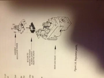

All right it is an 820 NOVA SIT. I can't remember how the NG regulator installs. There is a rubber diaphragm and a spring. We're there directions?
There are, but it shows going from NG
Says nothing about going to NG Just a photo removing
