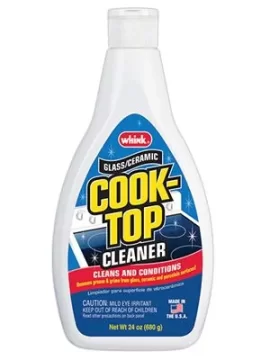

Go to Walmart & get a container of ceramic cooktop cleaner, similar to this product (below)
Spread it around with your fingertips, rub harder in the built-up areas & wipe it off with a damp towel.
If your glass has had this condition for more than a couple of years, you may nit be able to remove it completely.
