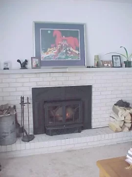

Been reading here for a couple months and what a great resource this forum is! I have a Jotul Kennebec that is finally installed correctly and working great. I'll save the installation story for another post. Where should I locate a stove thermometer? The insert sits back inside the surround and doesn't protrude anywhere (sides or top) that I can stick a magnetic thermometer to. I've seen other Kennebec owners post and refer to stove temps. Where are you guys placing your thermometers? I attached a picture to show the finished install.

I have one on the to pf my stove and also the front face kinda behind the door above the knife edge. I dont think the Kennebec has a place above the door. If you could get it on top between the shroud and the stove on top i would think the blower would off set an accurate reading.

I keep mine behind the cast iron front (doors, lip just behind the doors) on the steel top, just under the chevron/keystone/whatever-that-is on the center of the surround (assuming kennebec surround, not tamarac). With the stove all teh way in the sleeve, it's a bit of a chore to see the exact temps, but you can get a good idea of the temp once you're used to the thermometer.
I coresponded with a rep from Jotul a while back, and he confirmed that this was the place to monitor temps, if you wanted to do so (although the manual has no mention of temps, as you probably know, just the advice not to let the stove turn red :) )

Is that a picture of your install? If so, the hearth is _WAY_ short for the kennebec (18" from the glass is required, if I recall). I've had a log roll out and was VERY happy I gave myself 21+ inches of hearth. You'd probably be well advised to at least put down a hearth pad, if not extend your hearth somehow (even at the floor level).

I noticed that too and since you have a raised hearth, if a log falls out it's going down hill and will roll even more once it hits the carpeting.......

I have a raised hearth too, but a baby gate is installed in front of that, so any rolling comes to an abrupt stop (although embers can make it through).
However, I think that a flaming log rolling at you is the type of thing you only allow to happen once. I've been very careful since :)

Thanks for the location to put the thermometer Hal. I'll pick one up and wiggle it in there. I have thought about getting or making a hearth pad for safety. When we used to use the fireplace we would get a pop every now and then with a hot ember shooting out on the carpet. Several burns here and there. What a difference the insert is compared to the fire place! Got home from work earlier this week and the wife had it about 78 degrees in the house. Some of our wood is a little green, you can hear is hissing when the door is opened. After reading a while on here I've learned how to properly stack and season the wood.
Picked up a stove thermometer this weekend and put it on the insert. It's great to be able to see the temp rise when you damper it down. Now I'm able to fine tune it to get the max heat output. Had the thermometer up to 600 and man it was throwing out some heat.
