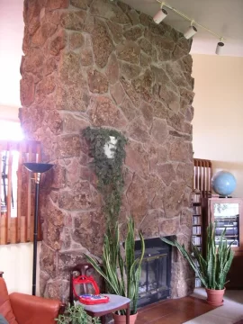

Thanks everyone. I haven't been back to look at my email or replies here since I posted. Come back to find quite a few of you have replied. I'd like to get a floorplan to you, but I don't have a scanner to scan a sketch. As far as starting all over, I'm hesitant to invest that much money, and this is a big chimney we are talking about. See photo attached. The stone chimney is on the mid level, with the upper level visible above. We probably spend $200 a month for electric heating in the coldest months (2 nights of -17 F this winter, but we also get sunny days). Just a small stove in front, new 6" liner, installation is putting us close to $3500, which will take some time to recoup. That's without tearing out this monstrosity.

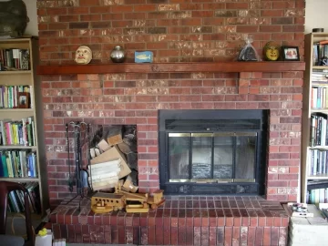

Here's another photo of the brick hearth that we would probably put the stove on. This is below the stone fireplace. The hearth is bricks on edge, not sure what they are on, but I imagine it is wood framing and not concrete. Sounds like the Jotul is a better option, as we would be firing it up after coming home from work, and cheaper than soapstone. I could also get a larger stove, enlarge the hearth a little, and have it top vent, then 90 into the brick and 90 again up the chimney.
The salesman told me the Jotul Castine, though larger, has more problems with rear venting and drafting than the F 3CB. Anyone know anything about this? Thanks again folks. This site is great.

I can see what you mean, that is a lot of nice stonework. How are the floors connected? With a narrow staircase and closed off rooms, or with wide open staircases and a generally open floorplan on the lower floors? If the latter, it should heat ok from the lower floor.
The salesperson is correct. The Castine's shallow firebox likes a strong draft if it is connected rear exit. With a liner, you might have that. How high would your stack be from the brick fireplace?
Another thought would be to not demolish the entire brick fireplace, but just take out the part of the hearth in front of the fireplace. Then rebuild it in brick, but maybe 6" lower and extended by another course of bricks, into the room. Done right this could be quite attractive and it would allow you to put in an F500 or F600, or Quad Isle Royale, or perhaps an Equinox?
Be Green - Yes the floor plan is really open, as you can see in the photo. The lower floor has a narrower staircase but it's only 6 steps or so, so it isn't that boxed in. The height of pipe from that lower floor is probably around 24'. I really like your idea of lowering and extending the brick hearth on the lower fireplace, thereby allowing me to get a larger stove in there. I've looked at the 500 Oslo and the Morso 3610 too.
I would also consider the F600 with it's right side door. The Oslo's side door is on the left. If the hearth is lowered, the door will need full swing range and easy access. Otherwise loading from the left side could be a pain. Alternatively, the 2 cu ft Quadrafire Cumberland Gap loads from the right side as does the 2.5 cu ft Hearthstone Bennington.
