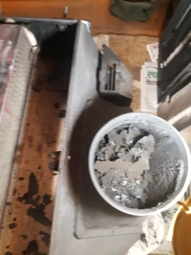

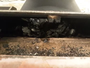

New to the forum, enjoying the insight and different experiences we all have with our burners. After 32 years with a CDW Sequoia I purchased the f500 dec30 2021. Loved the heat output. 2 months in had smoke spilling out the side door when adding wood. Removed top plate to find a deep pile of creosote at base of pipe. Additional creasote piled on 18" horizontal into chimney. Some glazing and curls on side door. Same wood, red oak, drying process as in past. NEVER had these issues with Sequoia. Consistently run at 500 degree top plate temp, 1200 at cat probe as book recommends. Interesting to know of others having similar issues. Otherwise love the stove. Isnt creasote formed from the cooling of a gaseous vapor that then condenses on surfaces? Creasote inside the stove, what gives here?
EatenByLimestone
Moderator
Staff member
Just to get the basics covered, how tall is the chimney? What size is it? And how long has your red oak been cut/split and stacked to dry?
