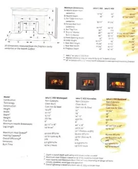

The Jotul printed wood insert product guide has the specs on the C 550 Rockland unit.. if the attached scan is not clear enough, or if you want another pic or info, let me know.

Re: firebox size.. according to my dealer, the Kennebec is rated to heat up to 1800 sq ft and the Rockland up to 2000 sq ft.. they also said the firebox on the Kennebec is 3cu ft and that of the Rockland is larger. That said, I have no printed info from Jotul to support this info, and I am no longer taking their word as law considering the blower outlet info.
