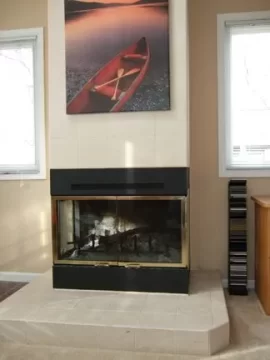

Thanks for the replies. I do like the Morso 5660 insert and I think it would fit. I have been told that I need a "zero clearance" insert because I am replacing a 3 sided glass inefficient box which sits under an inside wooden chimney and is fairly close to other combustibles. Any comments on whether the Morso is zero clearance and general comparison with the Jotul c350 Winterport would be appreciated. A photo of the existing is attached and this link is to the Jotul UK site for general info re their overseas inserts.
