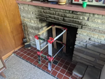

I am looking for wood stove to fit in our existing fireplace (30" x 30" opening). I need a rear vent to fit the stove which limits my options. I have narrowed my search down to the Jotul F602 and F45 Greenville. I mocked up the size of both stoves with cardboard which you can see in the attached photos. I am leaning towards the F602 but have some questions:

  • [Hearth.com] Jotul wood stove selection help needed
I would go for the F45 with the larger firebox. This will provide heat over a longer period between reloads. The F602 is a more radiant stove that is not going to help that much here and it has a fairly short burn time of 2-4 hrs..
I'm less concerned with the reload time. We use the basement mainly in the evenings. We would run it for a few hours and the go to bed upstairs where it is warm. Would this change your recommendation? Do you think the 602 is sufficient in that space?
It will warm the space, but with less to spare to heat the upstairs during a power outage, when the longer burn time becomes much more important. The F45 also has a much better fire view. Overall, it's a nicer stove.

I do prefer the fire view on the F45. It would cost about $1300 more than the F602 though. I agree that the 602 won't do much for the upstairs during a power outage but I was thinking we would just sleep in the basement. We have had 1 winter night without power in the last 3 years so I don't want to solely make a decision based on whole home heating.

You should be able to just cut out the vinyl over the concrete, you can then put some tile or even what you suggested over the concrete to meet code. And I agree with Begreen go with the F45,

Go with the F45, but pushed out into the room (larger hearth). You will get plenty of heat and a bonus is the north/south loading.
