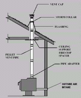

The pipe hangs off a gimbal mounted on the joists on the roof and is self adjusting so that it goes down straight. Your roof has to be pretty far off for it not to work..
If you're asking about where it attaches to the roof, the bottom of the gimbal is sheet metal and can be bent
In the attached picture the gimbal is called the storm collar
The chimney does not hang by the storm collar at all. In most cases it is supported at the bottom by a support box and then some depending on the height maybe some additional support brackets along the way. There are roof supports that do hang the chimney that go under the flashing but they are totally different.
The pitch being off a little wont matter at all. At worst you may need to trim the top of the flashing a bit but probably not.
You're right..looked wrong when I posted.. in fact the picture shows a box just as you describe
That said, mine hangs off a support on the roof joists, not supported at the bottom pr by a box.
. It dangles like a ceiling fan off a gimbal I guess hanging off the box is similar. In my case the ceiling is cathedral and there is no place for a box on horizontal joists
Don't know if it is that unusual, the building inspector passed it
Perhaps different methods are used by different vendors
Cathedral and ceiling support boxes are more common, but roof support is an option with some systems. Hart & Cooley has one attached to the chimney section.

Yes.. that's what I was (poorly)trying to describe. In my case the "wings"are attached to the chimney by a ring colar
