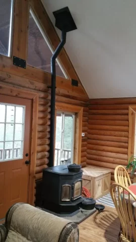

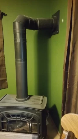

Holes are already cut, just need to be enlarged. Question, though...the owner's manuals on both require a 15 ft chimney. The lower floor currently has 36" of vertical pipe, then a 90 degree elbow, then a 15 degree elbow, then about 10" of pipe to the wall. Once it gets thru the wall, it will 90 again, and go straight up. I'm going to try to get rid of that 15 degree elbow, and put on an outside air pipe just in case, but how much higher does it need to be to make up for that horizontal run? And where does the 15 ft start from? The stove or the floor?
Top floor is easy, straight run into the thimble. Existing thimble will need replaced.

[Hearth.com] Just bought 2 stoves (Madison, Tranquility)...I'm now a nervous wreck. [Hearth.com] Just bought 2 stoves (Madison, Tranquility)...I'm now a nervous wreck. Trying to post a pic. Might make a mess of it. Hideous color green room is the first floor. Green room propane stove. Other one is second floor pellet. Pellet stove from the front, the pipe runs straight.

Are both floor chimney pipes 6" to which the 4" stove pipe runs through an increaser to the 6"? If so, that's good. If not, that chimney and wall or ceiling exit will need to be redone.
If the downstairs wall thimble is for 6" then consider coming up from the stove a short distance of say 18", then a 45 elbow to a straight diagonal section connecting to another 45 at the wall thimble. There are offset charts supplied by the stove pipe mfg. that will help measure the offset.
