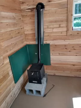

This is the inside, I'm currently insulating it with styrafoam. Sorry i can't reply to you for some reason my browser messes up.
Ok so in your case the support box will be mounted at roof level with framing added between the rafters to support it
That looks to me like 24" on center 2x6 cons, your going to need to box out and install a cathedral ceiling support box or a class a support bracket that supports the class a pipe and allows the single wall pipe to mate with the class a, I personally prefer the cathedral ceiling support, but it may look clunky in your application.
Just got the guy from my local store to swing by and said he only installs ICC pipe which is really expensive. Said I should get 4 feet inside and 6 feet outside plus a cathedral ceiling support box. Told him my stove needs 12 feet but he said to try 10 because 12 will look stupid on my shed roof.
Looks like some re-arranging is going to happen where ever you place the stove....
Drolet is a good brand, I had the drolet el dorado which must be the earlier version of the escape. You're gonna like it.
Don't know where you are located, but why don't you insulate with rolled faced fiberglass? Looks like 24" OC studs?
It's an easy enough job to run the vent pipe also instead of paying someone else to do it and then thinking, "Chit! I could've done that!"
Pics when it happens either way......
Yes some rearranging will happen for sure, my shed isn't water tight so I'm afraid of mold that why I'm using styrafoam. I wish I bought a different shed. I tried my best to water proof it but still don't know if it's 100% water proof or not.
