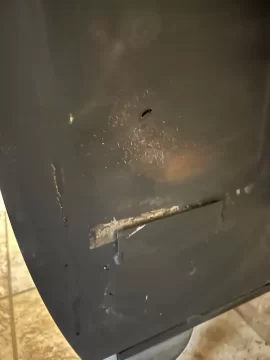

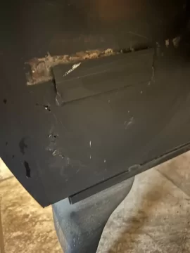

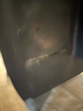

Just found small holes in the back of my Blaze King King kE1107.
05ramctd
Oct 29, 2013
113
NEPA
Was cleaning up my BK today and removed the fans as I do every year for a total overhaul.
The model # is KE1107LBK. Never did I think I would see holes in a steel stove. We purchased the stove in 2014 new, from a local dealer. I would have to say my only recourse is to weld plates on the outside and hopefully on the inside. I did nudge some stove cement on it to start a small test burn but this might explain the smoke smell I had last year. Has anyone had this problem or any better ideas. Been retired money is tight and can’t afford another stove.

I’ve definitely seen it before on a king model. Might have been on another forum. On the back like yours.
Unfortunately, yes this is very uncommon but can happen when creosote forms in the back of the firebox and is neither burned off nor scraped off. Another reason to have a hot fire periodically is to keep creosote from forming and then causing this issue.
You can certainly weld a few cover plates over the damaged area on the outside. However, you need to also be able to remove on the inside and creosote or metal that is damaged from the creosote.
If you run the stove on low continually, please run it on high (hot) once or twice a week. In order to remove the inside formation of creosote, try a weed burner at the same time you have it out for welding.
PLEASE BE CAREFUL AND REMOVE CREOSOTE PRIOR TO WELDING OR YOU COULD START AN INTENSE FIRE IN THE FIREBOX.

Well I removed the brick a scraped the affected area and more . Then wire wheeled the area. Only found 18 gauge today and I may cut and insert on the inside. It was amazing the damage to the metal it was paper thin in areas, it looked like metal that was fifty years old. Planning on getting thicker plate. Didn’t install anything. I’m pretty good with stick welding, but may need to use mig on the inside. Will see. Any pointers will be greatly appreciated.
18ga will burn through easily if you put it on the inside. You need to make it out of the same material the stove body is
Nine year old stove😳. Not good.
Reactions: farmwithjunk
The king has those heat shields welded in on the rear above the brick line. Are you pretty sure the only damage is down low behind the brick?
I removed all the brick an hit every thing with a wire brush. Only found damage in left and right bottom corners. But i did find thin metal to the right middle next to the heat shield. But no sign of interior damage in that area just thin. Pretty disappointing and discouraging for the age of the BK . I did clean it twice a year religiously when I clean the chimney since I hav owned it. Have not removed the brick in three years though did not think it would have been a problem, nice surprise.
Don't beat yourself up. There is nothing in the manual to suggest this is required maintenance.
